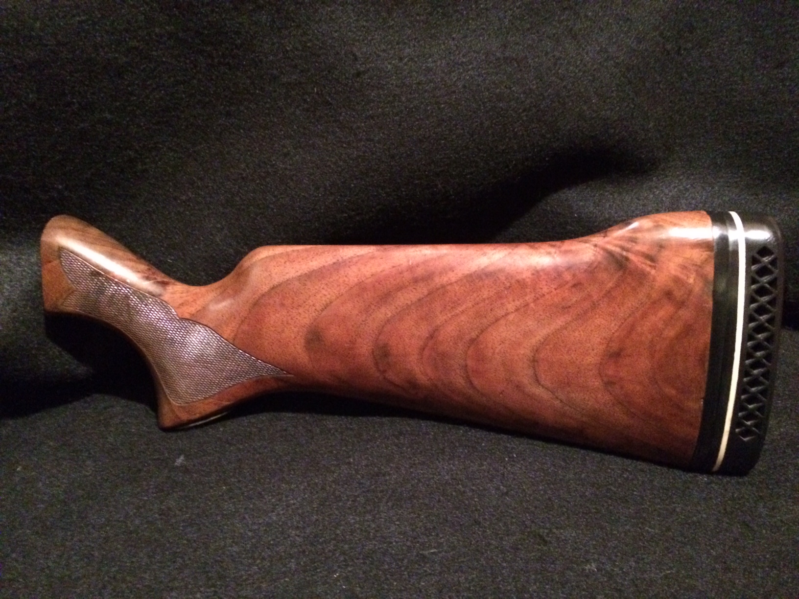

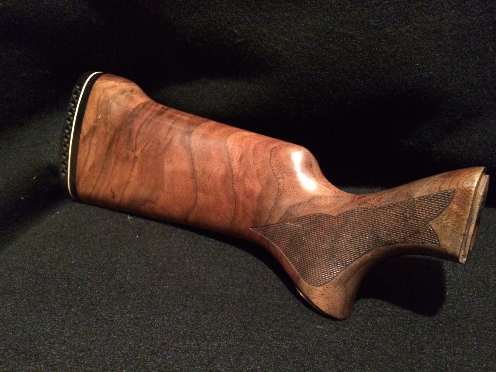

  20. User 1
    Ljutic made a "reverse montecarlo" stock back in the day .....
    Trapshooters seem to purchase anything "new at the time" that is supposed "help" with something .....
  21. mudpack
    That was my point.

  24. Jon Schorle
    Jon Schorle Chiefjon
    As a bona fide recoil sissy, I use PFS on both my unsingle and topsingle. I think there is a difference but stock fit and recoil reduction devices make it all good.
  25. mudpack
    "...top single barrels becoming more popular than unsingles" ??
    I daresay they've ALWAYS been more popular than unsingles.
  26. ljutic329
    Shooter in pic is Britt Robinson, one of the best ever.
    I know him and discussed this issue with him since I'm one eyed.
    He stated, made absolutely no difference. Depends on the shooter and what he prefers.
  27. Trap3
    Trap3 Mega Poster
    That`s the stock from J.O.Bates old standard rib Ljutic...
