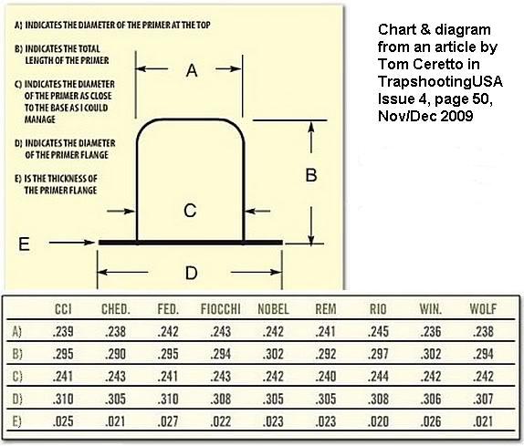

    At the base a Cheddite should measure .243 and a Winchester .242. I have a chart but can't see how to post a picture on this site.

  7. Mike Poore
    Mike Poore Active Member
    Ken, I believe there have been some physical changes by some manufacturers since that chart was published. It's been reported that Noble Sport has made physical changes in their product, and perhaps Cheddite. According to a Winchester insider, Noble is now being used in Winchester ammo produced in Europe and is now the exact dimension as Win 209.
  8. Ken Cerney
    Mike Poore that is entirely possible the Cheddite I have are a few years old
