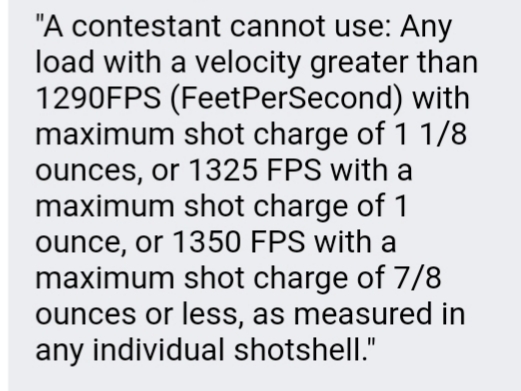

    ATA Rule Book, pages 48-49 set the maximum velocity of any single 1 1/8 oz load at 1290 fps.
    All chronographs I am familiar with report velocity data in fps and determine average, standard deviation and extreme spread. These are helpful to the reloader but do not guarantee that a given load will not exceed the ATA velocity limit.
    I have settled on a load that uses 2.7 grains less powder than the powder manufacturers load data for 1200 fps.
    It chronographed at 1219 fps AVG,14 fps SD, 42 fps ES. I also recorded the highest velocity at 1235 fps and lowest velocity was 1193 fps. I am confident my load provides adequate performance and are ATA legal.
