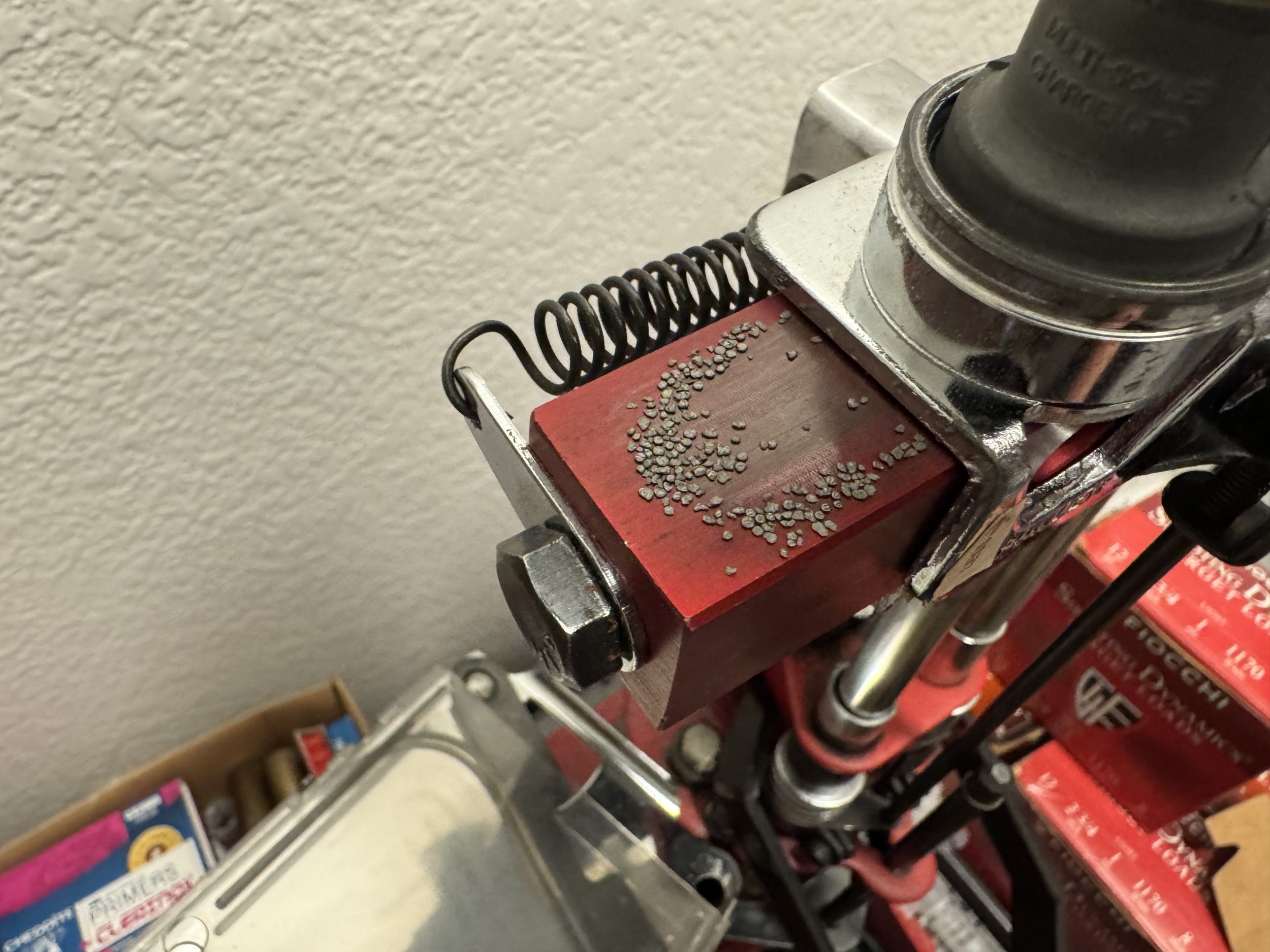

    What causes this and how do I fix it?

    It should say Mec Help
  3. brown hat
    brown hat Member
    Check your to see if your o ring and brass washer are installed
  4. rrisum
    rrisum Mega Poster
    New brass washer, put in the right way and a new rubber washer, not a o ring.
  5. Marcus Taylor
    Marcus Taylor New Member
    New brass washer installed directly on top of the charge bar with dimples up or on the bottle side and a new rubber washer on top of the brass washer.
